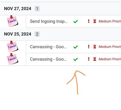

I insert in action inline button behavior:
but now also the column (and not only action button's icon) where action button is inline is not shown anymore in table view, while it's shown in detail view ... how to solve that ?
The issue seems to be related to add to column inline, when i add to that column the action button inline the column disappear from table view and is visible only (with related action icon inline) in detail view, is it strange isn't it ?
In the table view, if you attach an action to a field, then it seems the column value is replaced by the action icon. Therefore when you disable it in the table view, you do not see the value either.
So displaying only the value in the table view and both the value and the action in the detail view cannot be done in AppSheet.
