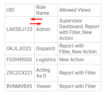

Yeah, the new "User Roles" I was talking about looks more like this tho:
UID Role Name Allowed Views
LAKSDJ123 Admin Supervisor Dashboard, Report with Filter, New Action
OKJLJIO23 Dispatch Report with Filter, New Action
FGSH9ISG0 Logistics New Action
ZXCZCX221 Acting As D Report with Filter
BVNMVB45 Viewer Report with Filter

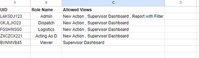

Ok.I have now my User Roles table like that:
UIDRole NameAllowed Views
LAKSDJ123AdminNew Action , Supervisor Dashboard , Report with Filter
OKJLJIO23DispatchNew Action , Supervisor Dashboard
FGSH9ISG0LogisticsNew Action , Supervisor Dashboard
ZXCZCX221Acting As DNew Action , Supervisor Dashboard
BVNMVB45ViewerSupervisor Dashboard

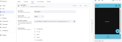

Yes of course,Herewith some screenshots illustrating the process:
  1. User Roles table:

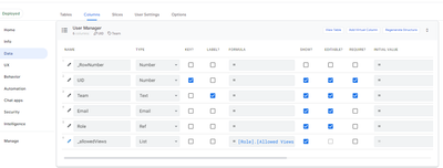

2. users table should be of type REF to your newly created "User Roles" table:
3.Virtual column in User Manager table:
4.Slice for menu table:
These are all the steps I followed , but I think the problem is in the expression as Current_User is not clear to which table you refer.
Note also that I have already created a slice from User Manager table named Current_User. with :
I even tested the 2nd option but does not work
Best regards

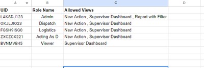

I have the User Roles table like that:
in googlesheet:
It displays nothing even for me when using slice filter expression:

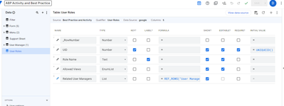

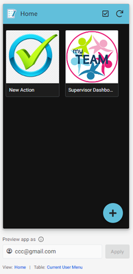

Have a look now:I have followed all the steps ,but got this error:
I fixed it, your Allowed Views and _allowedViews were configured as text, not enumlist of base text, that's why you were getting that error.
Also you didn't have a slice set up for that view.

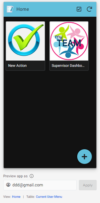

Here's the proof it works:
Rafael_ANEICPY_1-1713912874238.pngRafael_ANEICPY_2-1713912897050.pngRafael_ANEICPY_3-1713912912367.png
Hi friend;
Working as expected.I am very grateful for your valuable assistance.Thank you so much.
