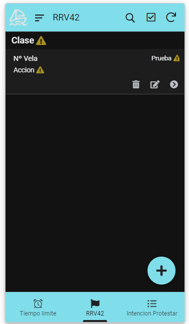

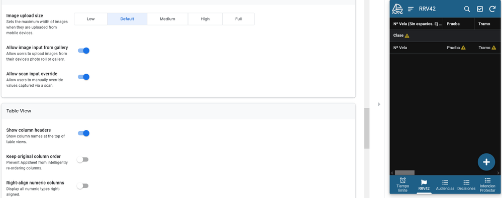

Show the header as a data
It happens in all UX views (Deck, Card, Table,…)
When I haven´t any data, it show me the view with the headers.
When I create the first data, it disappears.

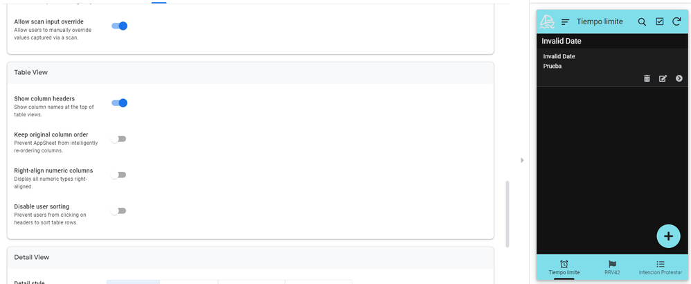

I try to change. UX / Options / Show headers and It doesn´t work.
I try to change. UX /Options/ Apply show-if constraints universally and it doesn´t work.
Any idea??? Thank you.

Please post screenshots showing the headers displayed and not displayed.

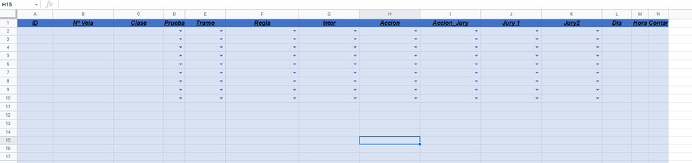

Show you the spreadsheet
Thank you for your help.

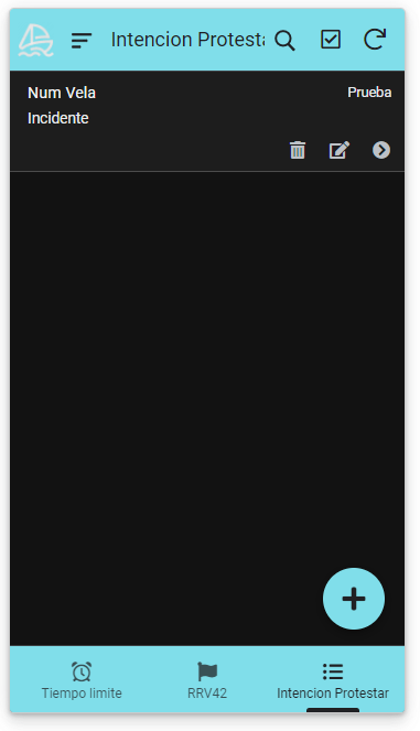

No show headers
Show headers
But Deck view options does not exist.
Or… I missed.
It think it is not a view problem
Here it is the spreadsheet (by google)
Ah! My guess is that some recent changes to table views have removed the option to hide headers, despite the availability of the configuration option.
@Arthur_Rallu, can you speak to this?
True! The option exists only for table views.

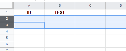

I have created a new spreadsheet, only with two column id and test
I have generated the app
Repeat the header as if it were data.
The header row should be in bold. Do that, the regenerate the column structure in the app editor.
See also:
As soon as you enter data, it disappears
No changes.
I created a new app with a new spredsheet (with headers in bold) and no changes.

The app screenshot shows a card view displaying one row. The spreadsheet screenshot shows a table with no rows. The two screenshots do not appear to be related.
True, but the app is reading this spreedsheeet.
I don´t know how to change it.
I haven´t any data in the spreedsheet, as soon as I have one row with data the bug dissapears. But if I haven´t any data the app show the headers as a data.

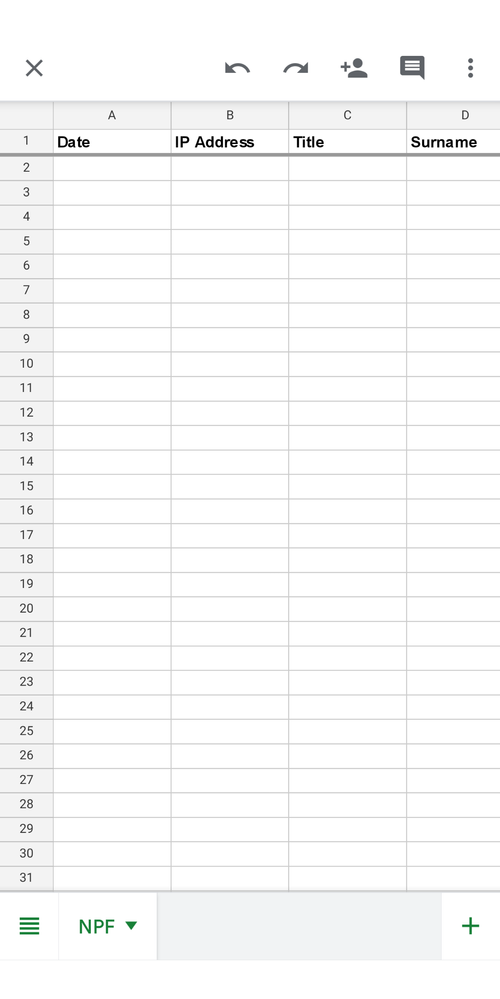

There is no data in my spreadsheet, but it will show header as the data in the apps.

FYI, I’m using the google spreadsheet and there is no content in the first few rows. Data type in the table consists of Email, Text, LongText, Number, Date, File, Image, Enum, Address, Phone and Name. I couldn’t reproduce it now.
It happens when I delete the rows in the spreadsheet directly. And I somehow found a workaround to it by inputting some data in the second row (Row after the header), and deleted the data in the cell instead of deleting the whole row.
