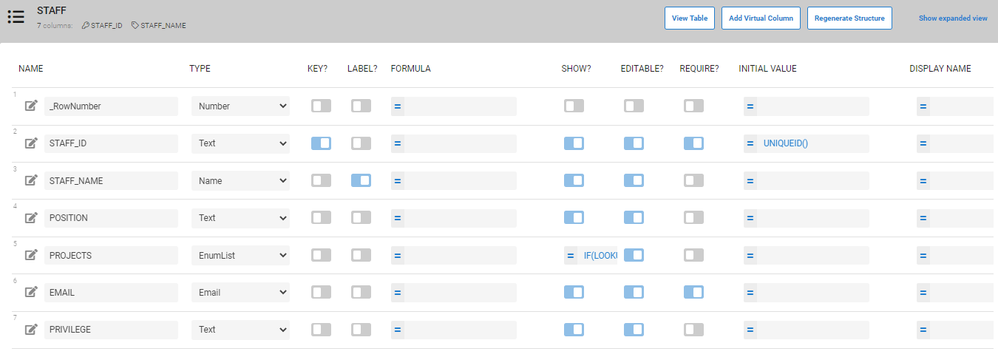

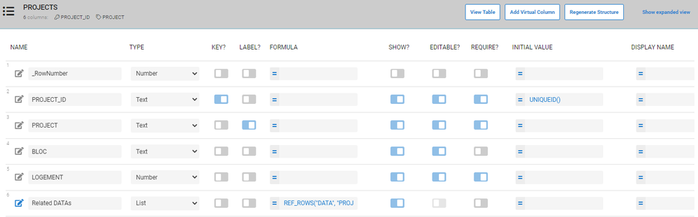

I add here pictures of the tables for getting better help.
STAFF TABLE SPREADSHEET
STAFF COLUMNS APPSHEET
PROJECTS TABLE SPREADSHEET
PROJECTS COLUMNS APPSHEET
These should be project IDs:
I thought the same but here is the problem that I donโ€™t know how to solve.
I have constructed this list to have a dependent drop-down list based on project and block selection. I have 19 projects and each project has 20 - 40 blocks. So I have recurring project names in total 728 rows.
Would it be work if I construct another project list just contains the 19 project names?
And can I get working inline views by projects also by doing this?
Iโ€™m afraid Iโ€™m not clear on what youโ€™re trying to accomplish:
In the projects spreadsheet, I had reiterant project names. I thought I could not make ref to all rows in that spreadsheet.

Projects
For that reason, I added another sheet called PROJECT_LIST that includes just the project names.
Now, I made this and it is working.
