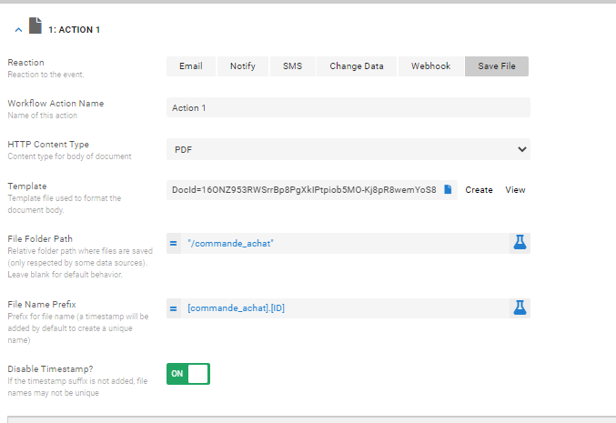

I did a workflow like :

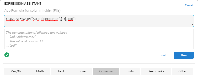

Also a virtual file type column :
The file type column seems to ignore the folder path part of the concatenation. I get only th ID part + .pdf. Of course the link does not work.
Does it look like a bug to you or did I miss something ?

When I remove the folder path from the workflow, the file goes to the “Files” folder (in the app data folder).
Then if I remove the folder path from the concatenate function, it fails (while it looks to the root I guess).
if I write CONCATENATE(“Files/”,[commande_achat].[ID],".pdf"), it fails too (still ignoring the folder path part.

#1 - Set the folder name in your Workflow rule like “/SubFolderName”. This will create a subfolder under the Appsheet/Data/AppName-123456 folder
#2 - The PDF file prefix could be <<[ID]>>
#3 - Then create a virtual File column with an app formula CONCATENATE(“SubFolderName/”,[ID],".pdf"). This will create a file name to your PDF. In the app it shows it just like “k8HtG6vS.pdf” if that is your ID column’s value.

The attachment file name needs to be <<[ID]>>, not just [ID]. That will create a file with a name “[ID].pdf”
Like this ?
The workflow make app error.
Actually with [ID] alone, the file name looks OK already.
I believe it’s not. It’s just updating the already exists [ID].pdf file because you don’t have any timestamp.
I confirm that <<[ID]>> in file prefix in the workflow make app error.

Just realized from one of your printscreens that you are actually using “Save file” action rather than “Email”. With the Prefix you need to use “[ID]” instead of “<<[ID]>>” which is little weird that we have different rule for two different actions. I will discuss about that with devs.

We discussed about this internally and it’s actually not meant to work like the original way even the sample app was working with that way. We are surprised that it ever worked as it should not. The correct way to do it is with the URL as…
CONCATENATE(“https://www.appsheet.com/template/getappfileurl?appName=AppName-1234567&fileName=SubFolderName/",[ID...”)
When you use a File column and app formula with this URL, it shows it like aSd765Tg.pdf in the app.
