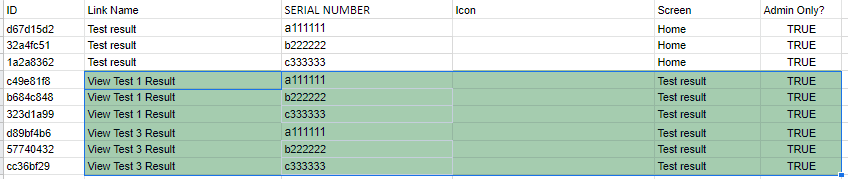

I’m trying to create a “Serial Number” App menu in the Appsheet. I want it that if I click an icon (Serial Number), it will only show the “Link Name/s” with that Serial Number.
Is there an easy way aside from creating multiple slices with filtering. AND(Screen = “Test result” , Serial Number = " XXX ")?

You dnt need any slices for such scenario.
Try to use LINKTOFILTREDVIEW() construction
Or you could build the connection into your data, and AppSheet will natively group all these sorts of things together for you.
