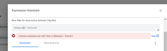

Hi, I'm trying to do a very basic slice. I want it to show only those schools listed as "active."
I *think* that this is the correct expression, but it doesn't work:
Can somebody help?! Thank you!

It sounds your [Status] column could be of enumlist type. If so and if you need only one value at a time as status, please make the column of enum type.
Yes! This was it! such a simple fix, THANK YOU!!

I think the answer is in the error message.
Try:
([Status]=Active)
without the quotes.
Thank you but that didn't work:
