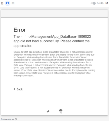

I connected the app with Supabase, but sometimes I encounter an error(if i refresh app working fine but some times this error occured) . Why does this happen, and how can I resolve it? I have tried refreshing the database and reconnecting, but the error still occurs occasionally. I need help to fix this issue. Please assist me.

Please contact AppSheet Support for help with this.
I contacted them, but I didn't receive a proper solution. They forwarded my complaint to the specialist team.
The AppSheet team knows about this but they are not into integrating with any platform nor would they help us giving us the technical behavior of the postgres connector.
Your best option is to pay for the addon so you get a dedicated IPv4 from Supabase
Thanks for your valuable feedback๐Ÿค. However, my client has only a free plan subscription. Is there any possible solution to fix the issue within the free plan?
Look for schema using 5432 and updates through 6543.
But it's messy
I also checked, but it is not working
