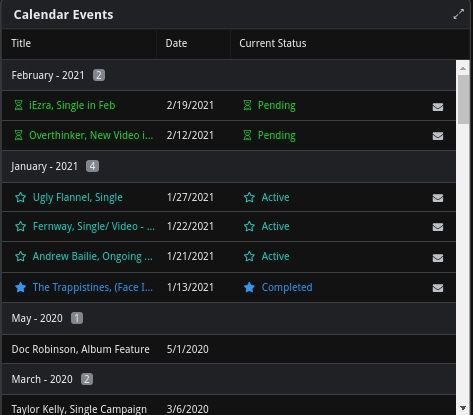

The dates in the actual data columns are numeric. This just converts the numeric version into each proper spelled out month, then sorts the months appropriately. Just NO DATE goes at the bottom after the oldest dates.
Could you elaborate what you mean by numeric dates?
In the actual data columns the dates are formatted like 1/1/2021 or mm/dd/yyyy
This expression assigns a month to each number, and parses out the year. I have the table grouped by month so it displays groups of calendar events within January 2021, Feb 2021, March 2021, etc
So it’s still sorting by number, but putting NO DATE after any number sorting. The only way to get it to sort to the top with a number would be to somehow assign ‘13’ next to NO DATE in it’s current configuration as opposed to ‘0’ as you suggested.

No the table is sorting numerically. Top to Bottom: 12, 11, 10, 9, 8, 7, 6, 5, 4, 3, 2, 1, NO DATE; with each number assigned to a month, and starting again each year change, with null dates at the end. It is NOT sorting Alphabetically.
I need it to sort like NO DATE 12, 11, 10, 9, 8, 7, 6, 5, 4, 3, 2, 1
Here is a screen shot of it properly sorting the months by number, not alphabetically.

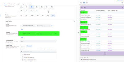

Hi, i am trying to achive what you show here. But i am getting the alphabetical order anyway... this is the formula and the view setting.
Here’s a picture of what I mean. But NO DATE labelled events are currently at the bottom of this list
