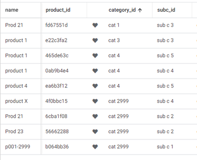

One thing to watch out for is that when you use a reference field in the expression, the key value is used instead of the label that you see in UX (i.e. customer id, customer name)  unless you de-reference it.
 Both caterory_id and subc_id are references and unless you de-reference them you get a result that is different from what you see in the table view (where it is sorted by category_id only)
