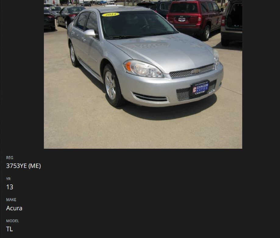

Thank you so much for the help! After a bit of changes, I was able to get it to kind of work. The issue now is that instead of the image being visible, the image hyperlink information is the only thing that appears.
Is there a step that I skipped
Thank you for the help!

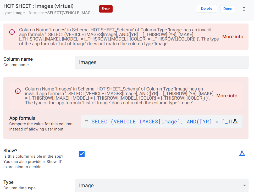

Steve. I tried it. But anything other then a List Type: results in the bellow message.
SELECT(VEHICLE IMAGES[Image], AND([YR] = [_THISROW].[YR],
[MAKE] = [_THISROW].[MAKE],
[MODEL] = [_THISROW].[MODEL],
[COLOR] = [_THISROW].[COLOR])
Hi Jean!
@WillowMobileSystems is correct.
It seems to me it is your deck view.
If the following is your detail view then no need any expression. Automatically, it will goto its detail view once the row of the deck is selected.
