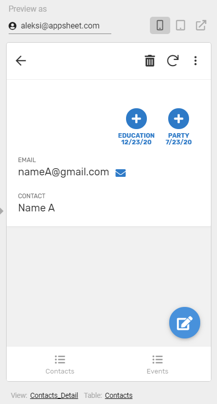

I modified one sample app a bit… please check “Invitation” app from www.appsheet.com/portfolio/531778

The app is created in a way that the action button’s name is actually the event name (active). It shows all buttons where the event is newer than today. This will add that event for the contact when you click that action button. Though I have added just two actions. If you have more than two live events, then you could create more than just two actions.
I changed Event names so it would be easier to understand. Please sync so you will see the update

Though there are many ways to build this kind of functionality. You asked an action in your original post and this sample is possible the closest. Your users should be able to select the correct event if you use good wording with the event name. This sample app shows them like this…
