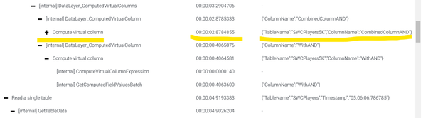

As an example in one of the test apps, the below reverse reference column has taken just 0.03 seconds to compute.
Each of the related records list  in that column has anywhere between 100-1000 related records from the child table as the following figure shows related values returned for just one parent ID. And the parent table has 5000 records.
On the other hand below are some VCs in the same app that have heavy SELECT() formulas and they start taking time.
Of course , there are exceptions in some cases. Please do share your observations if you can. Recently we responded to a post on reverse VCs taking time. I will share that post when I locate it.

Virtual columns with queries (FILTER(), LOOKUP(), MAXROW(), MINROW(), and SELECT()) are the most common causes of poor sync performance and are where you should focus your analysis when addressing slow sync.
REF_ROWS() is technically a query, but is much more efficient than the others and much less likely to adversely affect sync time.
