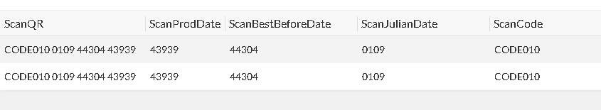

Hi @Ponch
Thank you. I was able to download the string from the QR code shared by you. Then in the back end data base ,I copied the tab equivalent space from the string and pasted it in the split expressions.
My testing went through correctly. I tested with virtual columns each of the below expressions though.
So , I suggest, please copy each of the expression below as it is and paste it in your app, one for each different split column. Only please replace the [ScanQR] column name each expression that I used in my testing with your column name that has scanned QR code string.
For Code :
INDEX(SPLIT(TEXT([ScanQR])," "),1)
For Julian Code
INDEX(SPLIT(TEXT([ScanQR])," "),2)
For Best Before Date
INDEX(SPLIT(TEXT([ScanQR])," "),3)
Production Date
INDEX(SPLIT(TEXT([ScanQR])," "),4)
Please ensure the column that store the scaneed QR string in the backend is โ€œplain textโ€ type.
My test results in the app display proper splits. Please refer app table view image below.
In case the copied expressions as above do not work for you, I suggest, please copy the tab equivalent space from the bak end database save string and put it in expressions.
Hope this helps.
