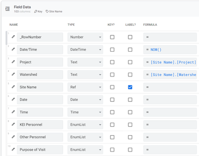

Could you mention the type of  the columns associated with [_THISROW] in the expression, namely [ Watershed], [Site Name] and [Purspose of Visit]
Yes. The Field Data table is where all the filtered rows should be coming from. The Reports table is the interface where Users will query the data they want from Field Data. The Site Name column in the Field Data table is a Ref to a parent table (Site Information).

This is so because [Purpose of Visit] are enumlist columns in both the tables and IN() requires the first argument to be a single element.

Could changing the enumlist columns to base type list be helpful here?
Sorry. I did not suggest INTERSECT() to be used for [Site Name] and [Watershed] columns. It will simply not work for those columns as those are not list type columns.
