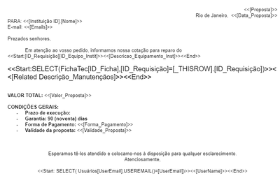

Please post a screenshot of your template.

Could you also post a screenshot of a generated report that demonstrates the problem?
Ok. Here it is:
Thanks!
You need to configure your template to explicitly include all the data you want. If you want individual column values from Related Descriรงรฃo_Manutenรงรฃos, you'll need to reference them as you have other column values in your template already.
Also, Related Descriรงรฃo_Manutenรงรฃos is a list of Ref values. To access the column values of each of those rows, you'll need to use another <<Start>>/<<End>> block. In this:
Replace <<[Related Descriรงรฃo_Manutenรงรฃos]>> with <<Start: [Related Descriรงรฃo_Manutenรงรฃos]>><<End>>, then reference the column values you want displayed within that block.
