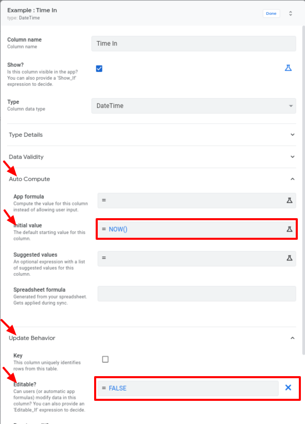

Rather than using App formula for Time In, I would recommend moving the expression from App formula to Initial value, then setting the column’s Editable? setting to the expression, FALSE. This will set the column’s value when the row is created (whereas App formula resets it every time the row is changed) and prevents the user from changing the value.

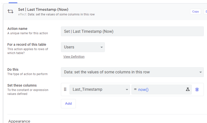

Hey @Steve_Tan I would make use of an action to set the timeout, giving the user the ability to tap it and set the actual time to “now” but not allowing them to actually modify the value.
For the timeout, I would put a show if formula to restrict when it’s seen so we don’t see it in the form
  • Show If: CONTEXT(“ViewType”) <> “Form”
Create an action that sets the value of the Timeout column (something similar to this)
  • For the condition of this action, use the following:
    • ISNOTBLANK([Timeout])
  • I would turn on the confirmation toggle, providing the user with some context about the button they’re pushing

Actions aren’t visible inside the form, they’re for modifying data outside in the other view types.
My suggestion was to move the “clock out” mechanism to an action, visible on the detail view (or possibly a table or other inline view) that the user can tap to clock out faster than having to go through the form.
