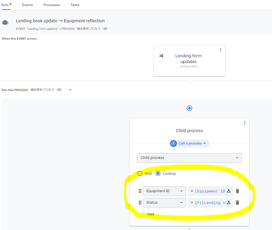

Hi.
I am making app that can manage equipment such as lending.

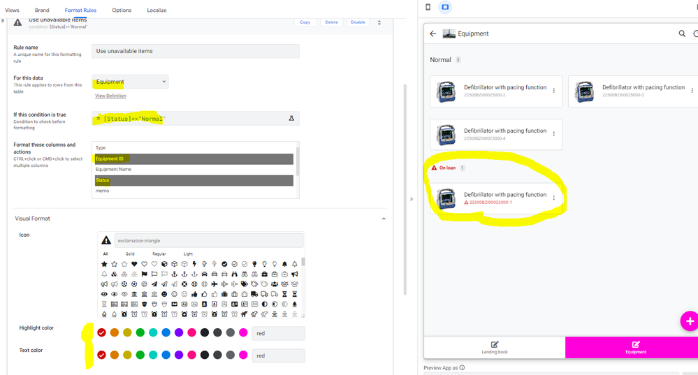

At automation proccess and formt rules, if [lending status] chages, the equipment that its status is changed become red color.

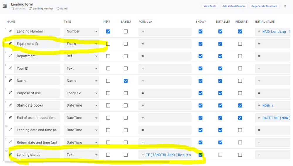

The equipment(column name is [Equipment ID]) set Enum. I am setting lending app as 1 item/1 ID
But I want to lend some equipment at once)/1 ID, so I would like to change Enum to Enumlist.
However, in that case, automation procccess cannot work successfully because if table"Lending form" [Equipment ID]  is Enumlist, app cannot lookup one equipment ID.
My settings are below. Could you tell me how to set automation proccess?

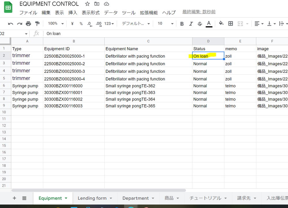

I have 2 tables. One is "Equipment", the other is "Lending form".
