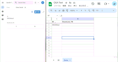

Strange behaviour when setting EnumList type, base type YesNo in Quick Edit.
1.The table below shows.
2.[EnumList_YN] is set as follows.
Column type: EnumList
Allow other values: ON
Base type: Yes/No
Valid If: LIST(TRUE, FALSE)
3.[EnumList_YN] is set to Quick edit columns in the Detail view.
4.When the actual operation is checked with this setting, the behaviour is very puzzling.
See attached video.
As the video shows, some values are recorded in the spreadsheet but do not appear in the Detail view,
In other cases, the same value may be entered in duplicate on the sheet.
I consider this phenomenon a bug.

The answer to the above is a filter dashboard, implemented with a combination of Detail view and Slice, for example, as shown in the video below.
https://www.youtube.com/watch?v=YKE9IKXzuSM
When I want to implement this kind of implementation, I want to select both TRUE and FALSE.
I had been aware of this strange behaviour for some time, so I dared not use Yes/No for the base type, but used Enum, Text, etc.
I would like this submission to be accepted as a 'bug report'.
