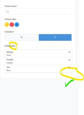

The idea is that in the Parent view form, if a Parent is set to 'Complete', the RO Child slice is used and if the Parent is set to 'Complete'=False then the UAD Child slice is used. This is to only allow the user to add children to parents who are NOT set to complete. This is achieved by using the show_if function on the 'Complete' property for the related  RO or UAD slices

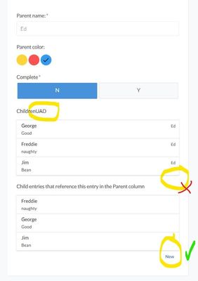

When I first set this up, I did it before I added the 'Complete' property and so had both RO and UAD child slices in the Parent View Form as inline views. Initially they had the appropriate 'Add New' functionality on the UAD inline view and not on the RO inline view as I expected.
As soon as I add the 'Complete' property, I find the process breaks as the UAD inline view  either refuses to show or does show, but doesn't have the 'New' record function on the inline view so no data can be added.
Most annoyingly, when I take the 'Complete' functionality and relevant 'show_if' code out, the UAD inline view does not re appear or if it does, it doesn't show the 'New' record functionality again. It's almost like the show_if functinoality is being kept somewhere within the background code - but it's really not consistent at all so that may be me reading far too much into it!
In frustration I put all the functionality back in and this time added the Childs data table (as well as its ChildRO and ChildUAD slices) back into the Parent View's Form using inline views. This Child table works as  expected but not the UAD slice.
This is where I have it now and have taken the following screen shots to see if anyone can help or recognise it as a bug. You can clearly see in the Parent View's Form that the Child's table inline view has the 'New' record functionality, but the ChildUAD slices' inline table does not - even though the Add, Edit and Delete Update Mode is correctly set on the ChildUAD slice. Please excuse the formating of this post - new here!

There are actually 3 "levels" to check when an Add button is not displaying - Table, Slice and then the Add action itself.
Do you have any Behavior logic implemented in the Child Table Add action that may be hiding the button...

Test this by adding a couple of new Table views into your app and link each new view to one of your child slices.
Switch to the view for the writable slice and verify that the system Add button is showing prominently on the view.  Do the same for the read only slice and verify that the add button is not showing now.
Also remember that each slice definition has the option to remove actions from the list.  If you want all the default actions to be available let the slice actions show as Auto assign.
