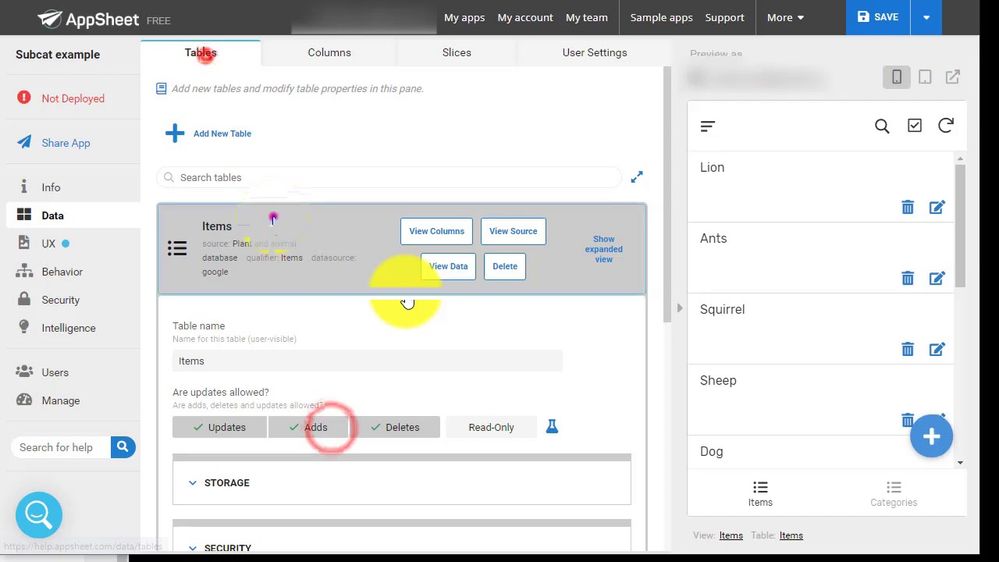

Bahbus I tried to follow your instructions - I made a quick video (2 mins) showing what Iโ€™ve achieved lol.
  1. How do you change the โ€˜Itemโ€™ tableโ€™s column โ€œItem Subcategoriesโ€ to be"EnumList of Ref"? (see 1m 08 in video where I get stuck)

  1. Column Type: EnumList - > Base Type: Ref. Do a Save & Verify. Then open the columns settings again so you can ensure the ref is being pointed to the right table.
