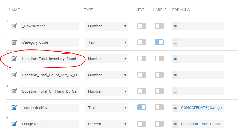

How do i total these items ( circled in the picture below)? This table changes regularly and i need a way to add them up. The table does not have a column “total” so i will need to do this virtually.
This is the data structure:

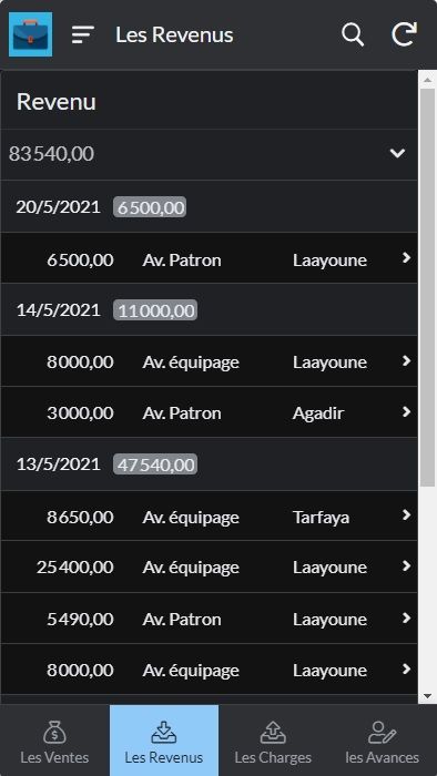

I’m not sure if I understand your requirement. You need something like this?

@Tiger Please check this sample app how you can calculate the total in the same table and show it as well. The app name is VirtualCounter. www.appsheet.com/portfolio/531778

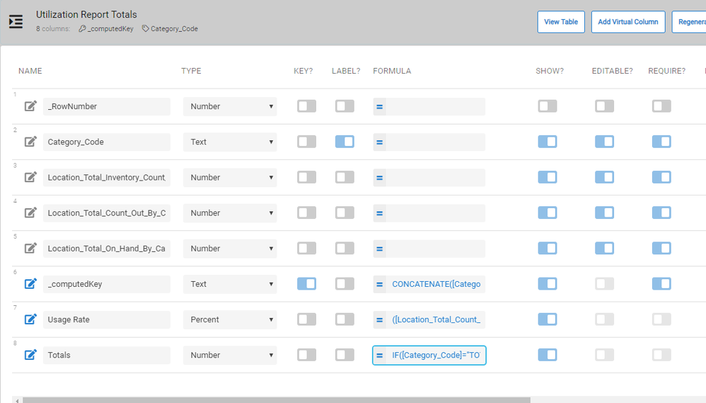

I tried this and failed. Here is the expression and my table structures:
IF([Category_Code]=“TOTAL”,SUM(SELECT(Utilization Report Totals[Location_Total_Inventory_Count_By_Category],[Category_Code]<>“TOTAL”)),[Location_Total_Inventory_Count_By_Category])
