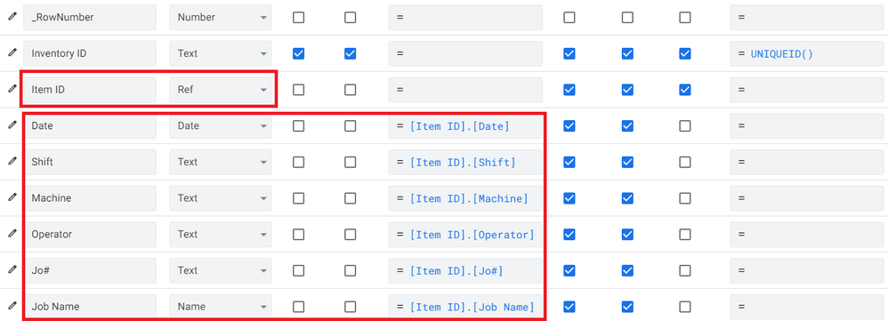

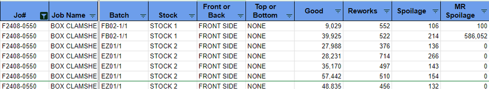

This is the example of what i want. Sum values of [Good] + [Reworks] + [Spoilage] + [MR Spoilage] by specific Jo#
Is your parent table with each row having unique [Jo#] ?
Hi @Suvrutt_Gurjar
The Item ID Only. Please see my data.
This one is the Parent
Then, this one is the child
Then my solution to get the Total is i create 4 virtual column for the sum values of each column. Please see my expression.
