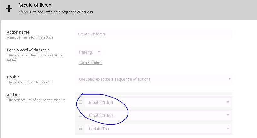

I have taken a look to the sample you made and Im a bit confused with the “Create child 1” and “Create child 2” actions you created.
I noticed when I create a new parent then add a new child and hit save, the app adds another 2 childs. I do not want my app to create breaks automatically, the user must add this. so I have tried to create the actions you have implemented, except “Create child 1” and “Create child 2”, but It does not work.

Sorry for the confusion… That was not even relevant, i just used an old app but i forgot to remove those actions.
Here is a better one, hope this will solve your problem
https://www.appsheet.com/samples/Sample-App?appGuidString=d7eeb9da-ec7e-4188-9b82-e7f441b896c3
