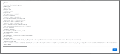

Here are screenshots of the only data I'm getting from an error standpoint. The top image is what you see when selecting the binocular icon in the error report. These errors are "Preview" = true but it also happens in the live (deployed) app.
Any thoughts or ideas would be greatly appreciated. I'm sure I've done something wrong somewhere, I just can't see it yet.

If you click on the "red binoculars" icon in the Log entry, you will be presented with more details about the error  -  most likely also including a message to explain why the Row Edit is failing.
If it is not evident what the error is, please post a screenshot here of the FULL message in that detail screen.  Maybe one of use can decipher it for you.
Thank you for responding. The first screenshot (Performance Details) is the FULL message. That is my issue at the moment, I can't see what the issue is.
EDITED:  I just realized what you were mentioning about "first screenshot"!!!  It wasn't apparent to me there were two images.  LOL!  disregard the below.
So if you explicitly click on the "red" binoculars, you don't get more information?  See image below

So lets back up a bit.  Looking more closely at your screenshots, I am realizing that these are from the Performance Analyzer.  It's tailored more towards giving run time details.
There is also the Audit Log which is where you want to search for app processing errors.  Have you also checked the Audit Log?
Here is what I get from the audit. I went through the last 15 or so errors and this is consistently the issue.
FYI, I have gutted the virtual column formulas and am playing with the AppSheet database for this. My use case is to have the totals for immediate reference as the input field is changed which is why I had used virtual columns in the first place. I'll update the post as I get through it but without the virtual columns I'm able to get the data to update without timing out for the first time.
