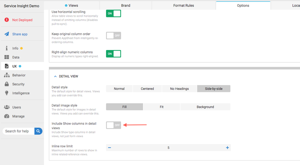

I haven’t done it but try turning on the setting indicated in the image below.
Tabs are not available in detail views (believe it or not).
Bummer! Curious about the setting I noted above, I decided to play and see how it works. It does display OTHER Show type categories (e.g. Section Header) just not Page Headers - which are used for Tabs.
Setting turned off
Setting turned on
If you are just trying to display the data while preventing edits, and not taking advantage of any features of the detail view type, you could create a read-only slice, copy the existing form view configuration, attach the copy to the read-only slice, and present that read-only form view. It would look exactly like the original form, but would not be modifiable.
