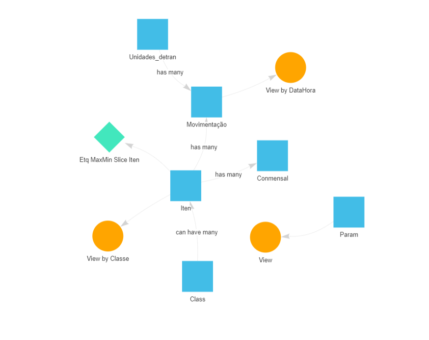

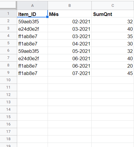

In an attempt to explain my problem in a simpler way to understand, I had used as example โ€œsales by monthโ€, but in fact i am designing a Inventory Manager able to calculate the
average consumption of stock items. So, just consider โ€œMonthly Consumption of this itemโ€ in place of
โ€œSales by monthโ€.
โ€œConmensalโ€ that means โ€œMonthly supplyโ€ is a โ€œview onlyโ€ table where i calculate the monthly supply of each item through of a query function on A1 cell.
The point is: How do I can extract a list from this Conmensal table ordened from buttom to top, and insert this list in a column inside Iten table on respective Item_ID, since ORDERBY() function takes the keys, and not the values, from Conmensal.
Sorry if it wasnโ€™t clear but i believe you can help me TKS

I achieved.
The solution has been create three columns in Itens Table which are: [MonthsWanted], [HistoricalSupplyKeys] and [HistoricalSupplyValues] being:
[MonthsWanted] = Non-Virtual Column where user input a value to determine average from values;
[HistoricalSupplyKeys] = Virtual Column Determined by function:
=TOP(ORDERBY(FILTER(โ€œConmensalโ€,([_THISROW]=[Item_ID])),[_RowNumber],TRUE),
[MonthsWanted])
And [HistoricalSupplyValues]= Virtual Column Determined by a deference list function:
=[HistoricalSupplyKeys][SumQnt]
thanks a lot for all posts!!!
