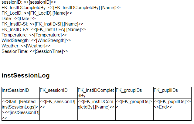

In a table I have an EnumList column which is of type Ref to another table.
When I come to create an email template how do I parse the values in this EnumList to then return the values in the table to which it references.
My template looks like (also attached as image):
sessionID: <<[sessionID]>>
FK_InstIDCompletdBy: <<[FK_InstIDCompletdBy].[Name]>>
FK_LocID: <<[FK_LocID].[Name]>>
Date: <<[Date]>>
FK_InstID-SI: <<[FK_InstID-SI].[Name]>>
FK_InstID-FA: <<[FK_InstID-FA].[Name]>>
instSessionLog
instSessionID FK_sessionID FK_instIDCompletdBy FK_groupIDs FK_pupilIDs
<<Start: [Related instSessionLogs]>><<[instSessionID]>> <<[FK_sessionID]>> <<[FK_instIDCompletdBy].[Name]>> <<[FK_groupIDs]>> <<[FK_pupilIDs]>><>
The field [FK_pupilIDs] is a list of the primary key field in the pupils table pupils.pupilID
This will return a list of values such as 123456, 234567, 345678
I would like to display the value in the field pupils.pupilName (e.g., Fred, Bob, Will)
Any ideas on where to start would be appriciated.
Many thanks
Paul

The final solution didnโ€™t require the dereference and so read:
<<CONCATENATE(SELECT(pupils[pupilName], IN([pupilID],[FK_pupilIDs])))>>
Hello @Paul_Robson, welcome to the appsheet community !
Thatโ€™s a very interesting question, how to turn a list of ref to a list of values from their respective table.
Try this:
CONCATENATE(SELECT(Pupil_table[Pupil_name], IN([Pupil_ID],[_THISROW].[Pupil_enumlist])))
Please do test this in a virtual column inside your instSessionLogs table and let me know if it works for you
