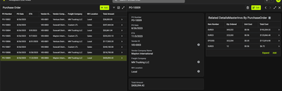

I'm using a bot to coping the data from a parent table to a child table, but when the action running it sends the values as ID, not as a Label:
I show you my screen:
This is my sheet table parent and child
  I can see the Label here but when I try to see the data in the view Details COI it just shows me the ID values!
Here is the View Details COI:
 I'm using the label in all the tables, but only show me the label in the first view in this one just the values ID!!
Do I need to activate another check box or do I need to use an expression to use the label in all my views?

If I understood your challenge properly, copying the key column's value is a normal behavior. If the column doesn't show the label value, your column's type in the app is not Ref, Enum or EnumList with the base of Ref. That's why it probably shows the key column's value.
