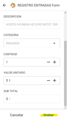

Friends, I'm trying to create an action that allows me to save data from a ENTRADAS table to the INGRESO UBICACIONES table that depends on a REGISTRO ENTRADAS form.

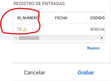

 Captura de pantalla 2024-05-05 144244.pngWhen I hit save, in the RELATIONSHIPS list an exclamation mark appears next to the registration number and when I save the main form, the action is not carried out.

 Everything else is executed fine, but the action that is associated with the BEHAVIOR, EVENT ACTION and FORM SAVED is not executed, I must edit the ENTRADA record and save it again for the action to be executed.

Child rows entered by going through the Parent Form, are not yet valid rows.  They are in a kind of cache so that If you CANCEL the Parent entry, any newly added children are discarded.  So, no Child Form actions will be run in this use case.   This is also why the Child Key column is presenting the Warning symbol...it is not yet a valid row.
Once you have Saved the Parent all cached children will also be inserted at this time - Parent first and children second. If you need additional activity to happen on the new child rows, there are two options:
