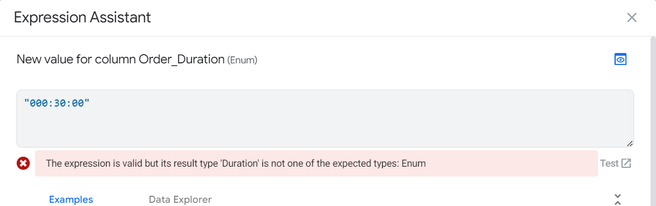

I made some test, and yes. I am also getting the same error both in action and action in bot.

It seems there's something with the Enum-Duration type right? Thank you very much for checking!
