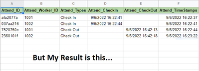

and My Result is

The issue is that you are launching the Form as NEW each time.  At the point where you are launching the Form you need to be able to identify that the user has already clocked in, i.e. there is a row with clock in but no clock out, and re-launch the SAME row for clocking out.
If you have a button where you launching this Form then you can modify the expression to using an IF().  If no pre-existing row then launch as NEW, eles re-launch row.
If you are using a view on the Main view bar then you will need 2 views, hiding/showing clock in or clock out based on if a row is already present or not.  If no pre-existing row, show Clock In view and hide Clock Out view.  Else show Clock Out view and hide Clock In.
