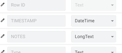

What data source are you using? It could be that you have specified the column type to something else than DateTime there.
It is appsheet database.
The column type is set to DateTime

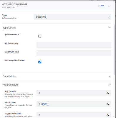

And your column type is set as DateTime and the initial value is NOW()?
This is what it looks like.

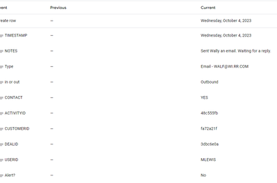

Check from the Audit history what value was recorded.
This is what it shows in the appsheet database  history for a row.

Check the latest logs and find a row that belongs to that table and it's "Add row". Then click the blue icon on the right. That opens details how the record was saved originally.
Ok. Found it and it shows the correct timestamp.

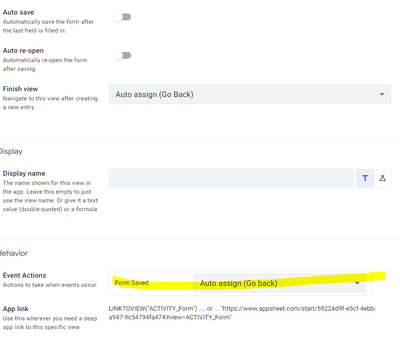

D you have any action manipulating the record when the form is saved? You can find it from that form view's definition. It's called Event action.
This is the formula within the action button that brings up my activity form:
Here is the event action when form is saved from the "Activity_Form" View
Meaning.. you don't have any action triggered when the form view is saved.
