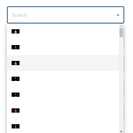

Hi @Suvrutt_Gurjar, I have been facing the same issue lately. I see you mentioned the issue is resolved on your end, however for me the images still appear very tiny when I use them in buttons or as dropdown.
Here is how my settings for the column are configured:
My settingsMy settings
With those settings, the dropdown in the desktop mode is as follows:
In mobile view the images are just a bit larger but still not usable:
The app will be primarily used on desktop so it would really be nice if I could get it to work on desktop mode. I'm tempted to think that the reason this is happening is because there are many images in the dropdown, but I don't think that is the case because I have tested out a small app with just two images and that still happens.
I do not seem to be able to find out why this happening or think of a solution to it, I will really appreciate any help on this.
@cmmasaba ,
if you refer the details, the original post mentions enum type columns with base type as image. Yours is a different configuration , you have enum type with base type as reference.  In ref column , I believe the image size is something similar as you have shown in the dropdown. Typically an image column is a label column in the referenced table and it gets displayed as you have shown with a text label. An example below

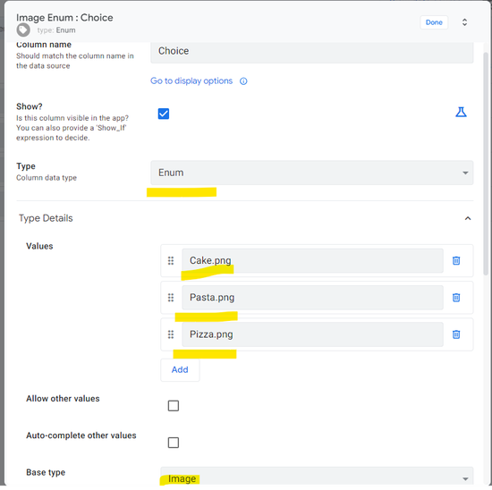

It sounds that you are using emoji to be placed in the enum values?
Please store the file name there and please store the image files in the same folder where the Gsheet of the app is stored.
Here are the details
The enum as it looks in the app form
The settings of [Choice] column
The storage of the image files in the same folder where the backend Google sheet of the app exists in the G drive.
Hope this helps.
