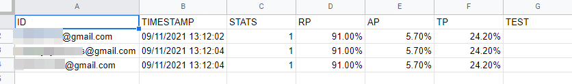

Table USERS:
Bot UPDATE USERS. With update for each row
When security filter is empty - all lines update timestamp and recalculate to the same RP,AP and TP
When security filter is [id]=USEREMAIL() - only first row is updated (see different timestamp on the screenshot)
The goal is that when a bot updates timestamp each row updates RP,AP and TP taking into account security filters. Values in RP, AP and TP are different for each row. This has been manaully checked.

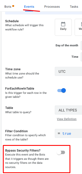

Does the first rowโ€™s [id] value happen to be the same as the email address of the app owner? I believe when the server processes something, USEREMAIL() returns as the ownerโ€™s email. In such a case, your Security Filters would prevent the server from seeing the other 2 rows. Probably a perfect case for usage of the โ€œBypass Security Filter?โ€ setting in your Event. Unless your calculations themselves also use USEREMAIL(), but perhaps that could be changed to just using the [id] value.
BTW, you forgot to redact the email addresses in your 3rd screenshot.

I think the answer might be that when a scheduled bot runs, UserEmail() = NULL. So alot of formulas which reference this will fail or act odd
Hi Simon. Thanks for swift reply. Is it mentioned somewhere in documentation that bots are running above security filters?
Thats an option in the bot, but its not on by default
