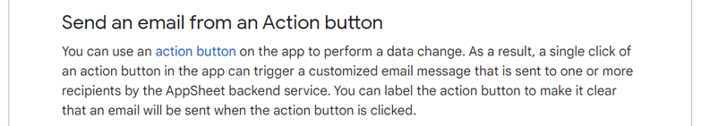

Please read the part "Send an email from an action button" in the help article below. The example describes sending an email. But you can invoke  other automations also from an action button. Basically the action button changes a column value and that in turn acts as a data change event condition.
