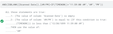

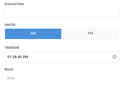

I don't see anything wrong with the expression.  I did a quick simulation just to be sure there wasn't any oddities.  See images below.
I would recommend double checking the data.  Make sure your [AM/PM] column is not blank and that there are no extra spaces in the values.
NOTE:  You probably want your time to be "12:00:00 PM" since you are using less than - unless of course you want the missed one minute span to count as PM as well.
Simulated expression - not exact but achieves the same

AM Value and time in PM returns "false"
