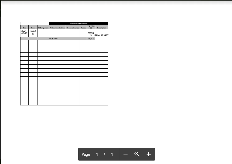

I try to make a PDF attachment in landscape. I make my template in google document in landscape but the PDF is landscape with portrait template.

Iโ€™m having this same issue. Trying to use a landscape template, but the result keeps cutting off the text as if itโ€™s portrait.
My template:
My Output:
My Settings:
I have tried A4 size as well, same result. I thought that custom setting the size of the page might change that โ€ฆ nope. The google doc template is set to landscape.

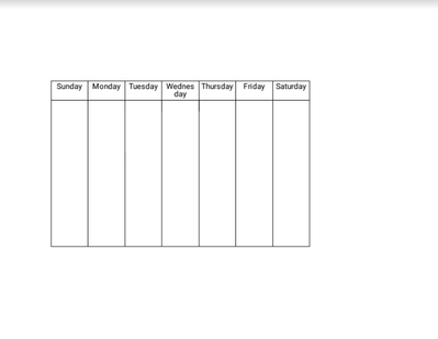

I have this issue with a table in Google Docs as well.  Whats weird is it's fine in portrait.  You change it to landscape and now it slices off about 30% off the right hand side.  Here's a simple example, created from scratch as A4 Landscape in google docs with a simple table:
Ran it as a template from a bot (Bot set to A4 Portrait):
Margins are slightly off, but its covering the full width.
Change Bot to A4 Landscape and we have:
So because the issue occurs when we change the settings of the Bot, I'd have to point the Appsheet Devs there first.  Changing the margins in the bot does nothing.  Also what is "pt" in terms of the margin settings?  Likewise changing the column widths in the Google Docs table seems to do nothing either ๐Ÿ˜•  Finally even tried Landscape/Letter in the bot settings - Same
If I was to hazard a guess I'd say that it looks like the Bot is constraining the width as though the paper was still portait.
Another quick test i've done. I went in an manually doubled the size of the last column in the Google Docs table. When I ran the Bot, the table in the PDF attachment was an identical width to before. Except now the last column was double the size and other others had all been shrunk.
