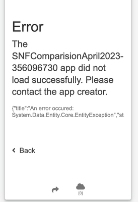

For reasons I am trying to figure out, users are having an issue with loading the application on a hit or miss basis. Sometimes it loads, sometimes its throwing out the error below. I've gone into the audit log but its not really helpful in identifying the issue. I own the file and the appsheet is set up to access as app creator. How else can I troubleshoot this? Could it be a quotas issue for Google Sheets?
Screenshot 2023-12-13 at 9.20.52โ€ฏAM.pngScreenshot 2023-12-13 at 9.13.32โ€ฏAM.png

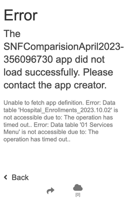

How many users do you have accessing the app concurrently?
Less than 10 at the moment.
#1 - Try to logout from your AS account and then login again. It refreshes the access token if that's the reason. #2 - Another thing to check.. check that all your tables are set "as app creator". #3 - When you open the gSheet, are you seeing the grey progress bar on the upper right corner?
This is happening even when using a new private browsing session logging in fresh. All the tables are set to access as app creator. The sheets are loading independently in the browser just fine. The sheets that have had issues don't even have much in them. The spaces table in another reply only has one entry at the moment... So not sure why there would be a timeout issue or the server error. It is accessing 8 tables concurrently but security filters are applied to some reducing resource utilization- neither of the ones that have thrown errors have or need these filters though.

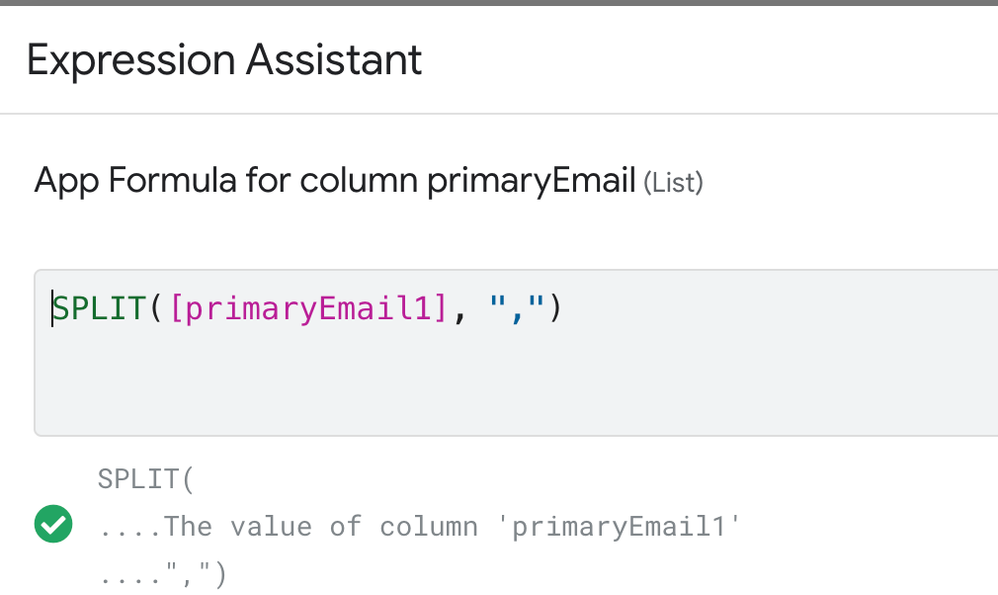

The current version of the virtual column that is is just an expression splitting for a reference. Splitting no more than 5 comma separated values.
