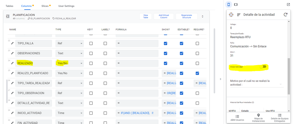

Hello everyone, I have a problem that I have not been able to solve.
I comment. The app that I am developing has activities defined in an installation that can have n equipment installed, when an operator starts an activity in an installation, it indicates if it has started. To do this, I generated a Yes / NO data. (REALIZADO)

But when returning to the main page where the detail of the started activity is shown.
The Start Activity (Iniciar Actividad )data, which was set to true at the beginning, takes the value false.

Doers the REALIZADO column have an Initial value expression? Is its Reset on edit? setting ON or have an expression?
Hi Steve, how are you? I share the images where you can view the configuration
I see nothing in that columnโ€™s configuration that concerns me. Thanks for posting it!
Do you have any Form Saved event actions or workflows that might be changing the parent table?
