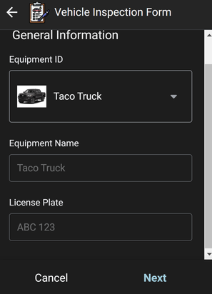

Here is another option to try for populating forms:
1. Create a new action on the table you would like users to fill out data for.
2. Use the LINKTOFORM() function to add specific information to a new form.
The result is a auto-populated form:
We also have a full webinar walking through this app build. Check it out here: Inspection App built with AppSheet
