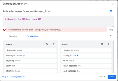

Trying to use Build list dereferences
I trying to transfer one ID value from table A to a column with ID from table B.
What is wrong here?
I have also tried:
But here is says it cannot compare type list to text while both columns are set to the type text.
Can anyone help me out what I am as a beginner missing here?
0 2 181
use this formula
LOOKUP([_THISROW].[Viswanvangst_id],"vistag","visdag_id","visdag_id")
use this formula
Thank you very much. You r help is very much appreciated
