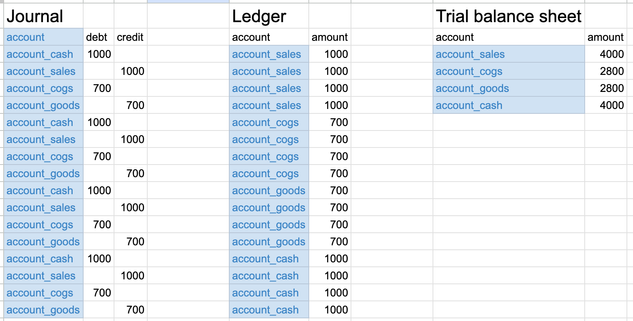

To help you understand, the ultimate goal is to aggregate the journal amounts written during the period into a trial balance by account. In other words, you can create a trial balance without a ledger.
Here are three examples of tables:
