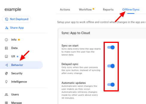

I recommend these settings:
Steve, I meant that values were not saved in correct field.
Now I have activated the three options you suggest.
