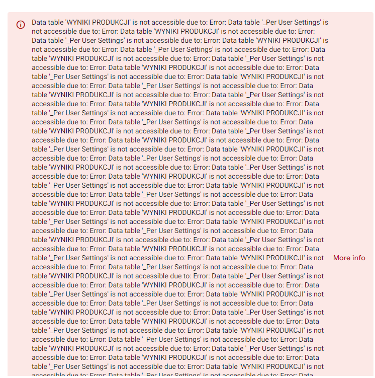

USERSETTING and security filter not working with 1 table
Iโ€™ve added usersetting โ€œZASIฤ˜G WPISร“Wโ€ (datetime type) which Iโ€™m planning to use with Security filter like:
[DATA]>= DATETIME(USERSETTINGS(ZASIฤ˜G WPISร“W))
Its working with almost all of my tables.
I have problem only with one table. When Iโ€™m trying to use this security filter I can see following error:
Any ideas how to fix that?

This usersetting is working well with the same security filter in another tables, where DATA field is the same column typeโ€ฆ I have no idea why its not working with this one table.
Iโ€™ve been trying with changing column type from datetime to date, also to textโ€ฆ still the same.
The problem was there were two references in User Settings to table WYNIKI PRODUKCJI.
When I cleared out those two expressions, that resolved the error.
I recieved that tip from AppSheet support, thank you guys!
