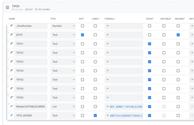

In a table I have the following columns: TypeID, Type1, Type2, Type3. Each column belongs to a language.

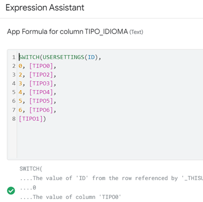

The Key is TypeID and the Label is a Virtual Column with the following expression:
SWITCH(USERSETTINGS(ID),
1, [_THISROW].[TYPE0],
2, [_THISROW].[TYPE2],
3, [_THISROW].[TYPE3],
FALSE)
The result is always FALSE. It is read by the USERSETTINGS ID. If I do the test with "Test" it works fine, but when I put the column in DETAILS, the result that appears is FALSE

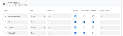

This is the setup I used
I appreciate your effort...
I've tried EVERYTHING. Still not reading USERSETTINGS(ID). It always returns the last value.

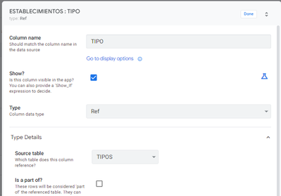

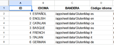

Andres_Belmonte_1-1706784873864.pngAndres_Belmonte_2-1706784915981.pngAndres_Belmonte_3-1706784935809.png
If you click on "Test" it does work
