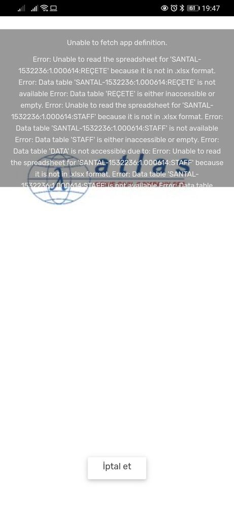

Unable to fetch app definition. Error: because it is not in .xlsx format
From time to time I am getting this error. My app is functioning normally but sometimes I am getting this error message. Every time I should open and save the backend file. In the editor, there is not an error shown.

I see your data source is probably excel files saved in the One Drive. As far as I know, whenever the file remain open, the appsheet app is not working. Meaning it should be default behavior.
That is one of the reason I avoid to use excel, but stay with Google Sheet, which is most seamless in terms of app operation.

When I tested Excel before with appsheet (some years back), I remember I observed same odd behavior, but not sure why it happens, but at least I learned Appsheet + Excel on cloud combination is not stable. All in all, I never use Excel as data source for Appsheet alone.
I agree with @tsuji_koichiโ€™s sentiment that Google Sheets is a better choice than Excel as a data store for your app. Excel is definitely limited, in that you cannot access the spreadsheet both via Excel and with the app at the same time. If the spreadsheet is open in Excel, the app cannot use the spreadsheet. Google Sheets does not have this limitation.
