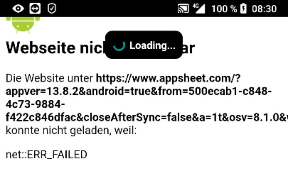

I see a white screen with net::ERR_Failed Everytime I try to open my smartphone app. I am able to launch the app in the browser and everything works fine.
I tried reinstalling the application using the installation link, but the same screen appears.
What could be causing this ?

I had the issue a few days ago, No devices where affected accept my own phone. I Just reinstalled the app right as soon as this issue popped up and couldnโ€™t get rid of it for 5 minutes. The reinstall fixed the problem immediately. Did not clear anything, didnโ€™t restart phone.
@Gil Since more people are having the same issue, here is some background:
I had a Sample Galaxy S10. Android was not updated. This randomly happened in the middle of the day while on the road. I didnโ€™t make any updates to the app.
@Fabian @Jonathan_S,
Were you both seeing the same error code at the bottom of the screen, net::ERR_FAILED ?
Yes
Yes

Hi @Gil Today it happened again with this Message:
This happened only to one Android Phone: Nexus 5x
Account ID: 1272826
appName=TimeTracking-622224
Chrome Version:
Clearing the Data of the AppSheet App solved the Problem.
It happened to me last week(wasnโ€™t the first time). Clearing the cache wonโ€™t do it. Clearing all data works. This error is not frequent, itโ€™s rather rare, but itโ€™s a pain in the ass when it happens.
@Gil today we had the same Error again. Same App, same Phone.
This time clearing cache didnโ€™t help. We had to reinstall the AppSheet App.
