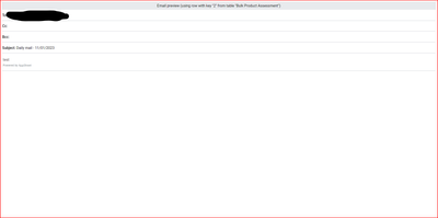

I have an app for which I am trying to generate an email report via the bot but for some reason the bot does not shoot the email. I have tried deleting the bot and creating a new one from scratch without editing any details in the default bot.
This is how the email preview looks like
All the tests and runs I have done for the bot show as successful without any errors.
But I am not receiving any emails, even if I just put a "test" in the body of the email. The preview shows that it should be working. I have tried checking spam folder and junk mail but no luck. Any suggestions?

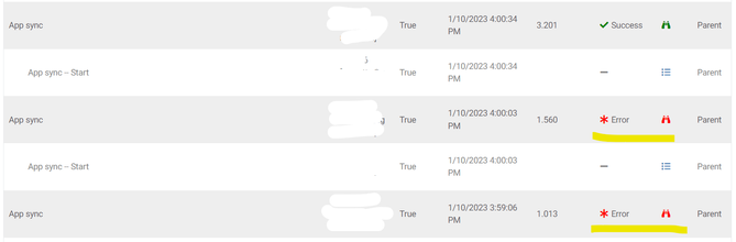

You may want to check  for any errors under the Manage --> Monitor -->  Audit History --> Launch Log Analyser option for any errors. Typically error steps should be shown there. Please  click on the red binocular option to see the error message.
Thanks for your feedback. There are no errors that I can see in the log analyzer.

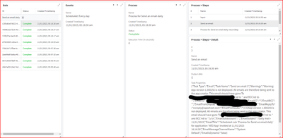

I, too, have a bot that silently fails to send email.  I have done this fine in the past, but this time I see the event and the process happening, and the log looks fine, but no email gets sent.
