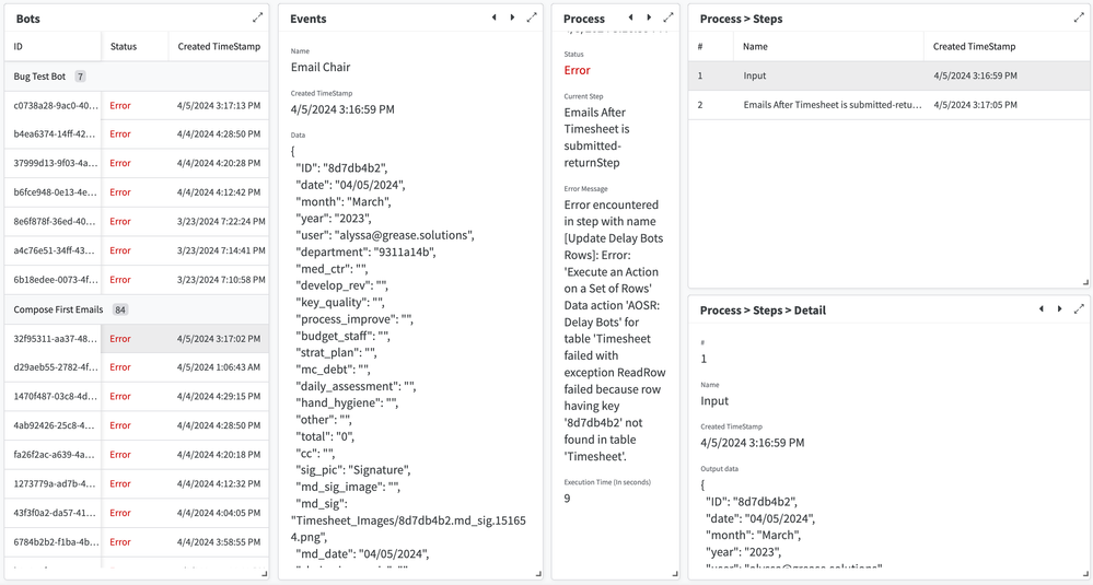

I have a bot that is running on Adds to the Timesheet Table - with no event condition. In the example below you will see that row with ID "8d7db4b2" was added to the Timesheet table and triggered the event. Then the Process fails because row with ID "8d7db4b2" is not found on the Timesheet Table. But if that row did not exist, then the event would never have been triggered.

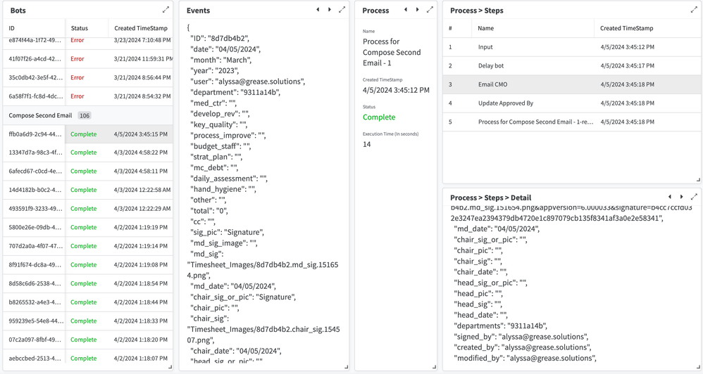

Related thing is happening on bots that are triggered by Updates. In the Event section of the automation monitor you can see that row with ID "8d7db4b2" has the "chair_sig" column filled in. But then in the Process>Steps>Detail you can see that the column is no longer filled in. The change in the "chair_sig" field is the update that triggered the event to run, but all steps in the process are running as if that change did not occur. Making any template not show the updated data that triggered the bot in the first place.
It is like every bot is running as if the data change that triggered the bot never occurred. I have tested this on other tables and the same thing is happening. It is like everything is stuck with a [_thisrow_before] in the backend.
